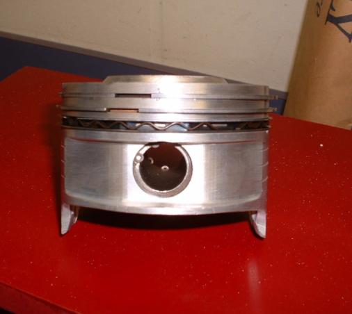

I found a set of 97mm aluminum Arias type IV pistions with Deves rings and cylinders. From what I have learned from the seller, these were made by Arias for Compitition Engineering during the "80's. Ray Lietz was the mastermind behind CE and they were a very respected machine shop in Calf. Ray died and/or the shop burnt down and that was the end of CE. This may or may not be true but it is what I was told. I'm sure someone here knows more. I don't have a scale to weigh these things but they are very light. They came with pins which have a very thin wall, see the picture. I know of one other guy that runs these and he says he is running "somewhere around10:1" c/r and uses race gas with stock F.I. Here is the best part: the price. I got pistons, machined cylinders w/ perfect fins, new rings, lightwt wrist pins, and clips for.....$200.00!!!! These have GOT to be worth $800!!! Here are some pics. Attached image(s)

Joe Ricard I don't think they are worth a crap. Just sen... Nov 23 2003, 07:26 PM
URY914 OK, I'll PM you to get your address.
:lol: ... Nov 23 2003, 07:34 PM
72914S Two years ago I bought a set of 96mm arias pistons... Nov 23 2003, 07:38 PM
redshift Great! You do know you have to take the motor ... Nov 23 2003, 10:08 PM
Brad Roberts Nice SCORE Paul. We normally lighten the stock 2.0... Nov 24 2003, 12:06 AM
URY914 Andy,
Who knows?
I'll ask Jake. Nov 24 2003, 06:45 AM
Aaron Cox or ya got to make valve cutouts in the piston top ... Nov 24 2003, 10:13 AM
URY914 I gotta a grinder. Aluminum is soft. :shades:
Pa... Nov 24 2003, 10:17 AM
Dave_Darling BTW, a guy named Walt runs Competition Engineering... Nov 24 2003, 05:49 PM
URY914 Thanks Dave,
Like I said in my original post, I o... Nov 24 2003, 06:03 PM![]() ![]() |
