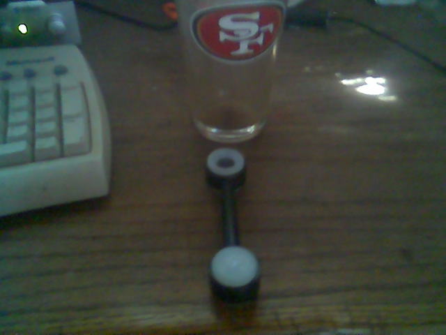

(IMG:style_emoticons/default/sawzall-smiley.gif) How in the heck do you get new polyplastic bushings into factory rear drop links for the rear sway with out messing them up
I have tried heat....cold...soap ...shoe horn.. Whats the deal do I have to big of bushing or something? Any little tricks to force it in?

Got em in next a c clamp to put them on.

Aaron Cox   they are a pain.. but doable. soften em up with h...   Apr 24 2007, 05:53 PM

blitZ   I microwaved mine in a cup of water for a minute o...   Apr 24 2007, 06:03 PM

Cap'n Krusty   I compress the cup and the link in a vise. One si...   Apr 24 2007, 06:50 PM

McMark   Cap'n has it right (duh) a vice is your friend...   Apr 25 2007, 12:42 AM
