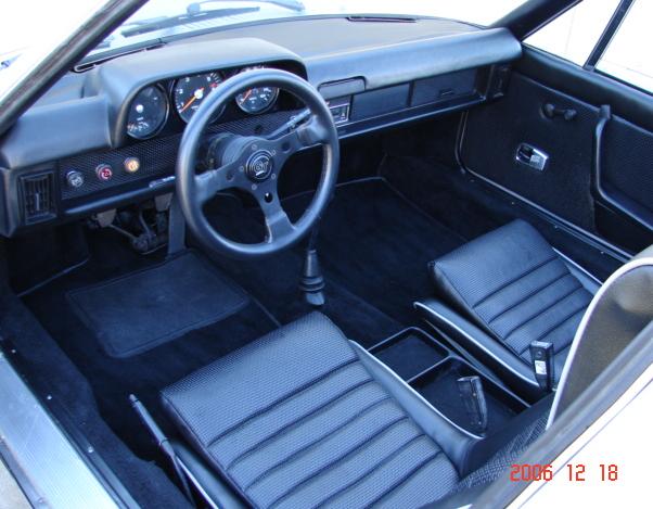

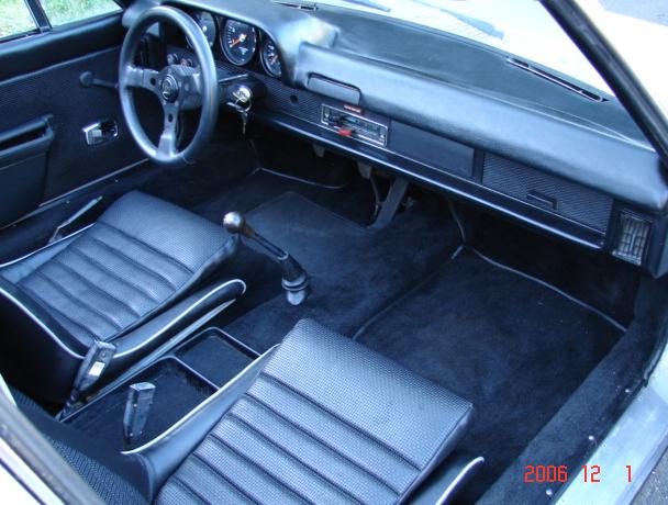

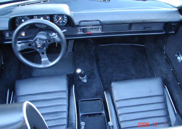

McMark   That's a sweet lookin' car. I can't w...   Apr 25 2007, 02:06 AM
mills914/s   Thanks Mark its been alot of work.But Its getting ...   Apr 25 2007, 07:57 AM
Gint   Definitely a great looking 914. Who's carpet?   Apr 25 2007, 08:11 AM
Rotten Robby   :sawzall: How in the heck do you get new polyplas...   Apr 25 2007, 09:50 AM
mills914/s   My friend does interiors for cars and ordered it f...   Apr 25 2007, 11:00 AM
