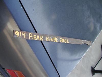

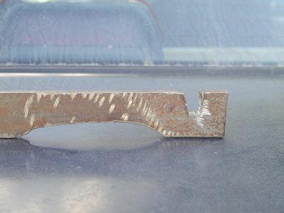

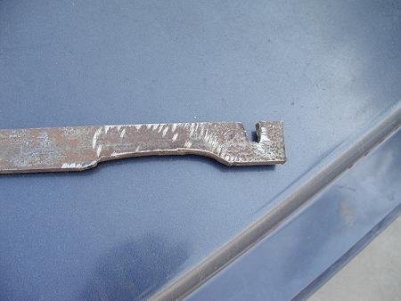

| JBart |
Apr 29 2007, 06:11 PM
#2
UNDER CONSTRUTION ![]() ![]() Group: Members Posts: 110 Joined: 9-October 06 From: Wildomar Ca. Member No.: 7,019 |
This might take a few minutes but I made my from 1/4 stock and a grinder . It works sweet!!!!!! Check it out. But you get done what has to be done !!!!!!
