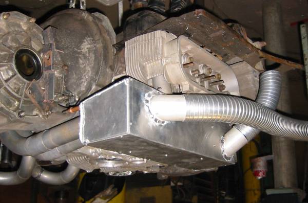

Forgive my ignorance. While I'm not new to vehicluar mods, I'm finding that the 914 is a bit different.
I couldn't help but notice the header thread that's a few pages back. It shows a number of pictures of some sweet headers that I may not be able to live without. The one I like mose is the Tangerine Header. As with any vehicle build, one must ask what the vehicle will be used for. In my case, it's a daily driver so defrosting and heating is fairly important. The question is, are there any headers that can have good strong heating? What header would you all recommend for someone that wants a quality unit that will later support, perhaps, a big bore kit, while still maintaning acceptable defrosting. I'm trying to buy stuff that I can grow into. I'm not afraid to spend $1000 on the good stuff, if I don't have to do it twice. Thanks in advance |

As a matter of fact I was working on the second and third prototypes of my heat exchanger/muff today. The first one ships out this week with the header I built it for.
Here's another pic of the first prototype: Attached image(s)

3d914 I could be wrong on this, but I don't believe ... Nov 24 2003, 11:00 AM
! Headers replace heater boxes......Bursch makes an ... Nov 24 2003, 11:05 AM
Bleyseng Stock SSI units with a Bursch or Triad is gud and ... Nov 24 2003, 11:07 AM
! SSIs are stainless copies of the 73-74 Heater boxe... Nov 24 2003, 11:09 AM
FEF I suppose another option might be a gas heater fro... Nov 24 2003, 01:04 PM
Dave_Darling I think the original heaters on the Bugs and Buses... Nov 24 2003, 01:08 PM
r_towle I was gonna say, Chris makes em with heat now... Nov 24 2003, 05:17 PM
DuckRyder Picture no worky,,,,,,,,,,,,,,,, Nov 24 2003, 05:19 PM
FEF HUMmmmmmmm
So I can get a Tangerine header with t... Nov 24 2003, 05:55 PM
