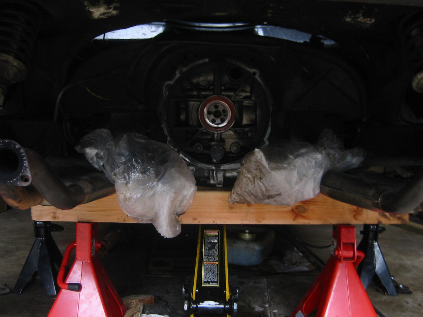

Here is a pic taken when I was about to remove the engine. CVs in bags, muffler off, 901 off, jack in place, and 2 x 4 support. I only had the one jack, so I used the engine bar on one and and a 2 x 4 on the other end to balance. It worked out great being solo - totally saved my heads when the engine broke free and lurched 3 inches down. The 2x 4 and engine bar rested on their supports before the engine could tilt any further on my small jack...almost tweaked the HEs real bad which would have pulled an exhaust stud and made a hole in my heads (no leaks now - it's all good).
