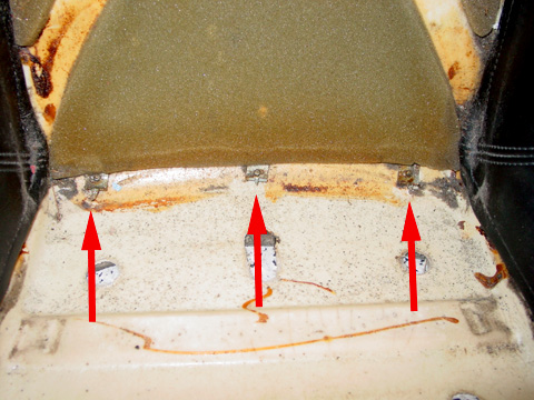

Remove the backpad. Note the three hooks at the base of the backpad at the back of the seat. Starighten them out with needlenose pliers and unhook the bottom of the backpad - see second picture. Swing the bottom of the backpad up and the top will come right off. It comes off very easy - if you need to force something, you have not completely freed the backpad from the seat.
