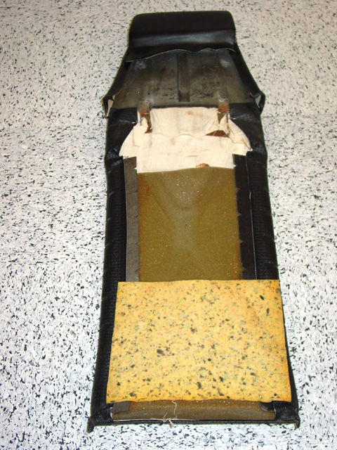

This picture shows the backside of the backpad. Note the locations and arrangment of the pieces.

nick mironov   This picture shows the backside of the backpad. No...   May 14 2007, 11:09 PM
