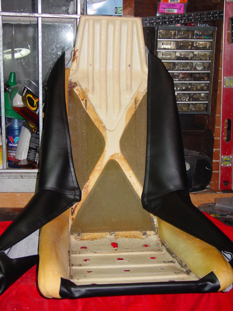

You are now ready to start re-upholstering the seat.
Glue on the front piece using spray adhesive.

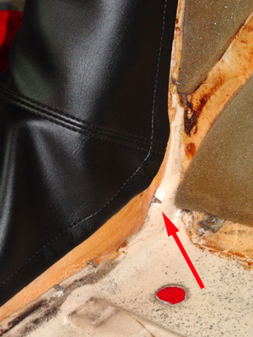

Make sure that each of the hooks has a sharp point and is pointing outward.
Insert the wire beads into the pockets on both sides.
Wrap the new kit fabric around the back of the seat - like putting a coat on it.
Start in the heel of the seat - by piercing the pointed hooks through the fabric above the wire bead.
Stretch the fabric and work you way toward the front and up. Bend the hooks over as you go to secure the bead down.

nick mironov   You are now ready to start re-upholstering the sea...   May 14 2007, 11:29 PM
nick mironov   Work the fabric by stretching the wrinkles out.   May 14 2007, 11:30 PM
nick mironov   Spray glue on the botton of the seat and on the fa...   May 14 2007, 11:31 PM
nick mironov   Glue the "shoulders", stretching them as...   May 14 2007, 11:35 PM
