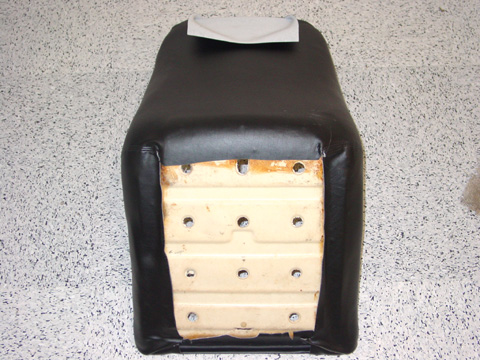

Spray glue on the botton of the seat and on the fabric, let dry, and then stretch it into place, taking out any wrinkles.
Find and cut the holes for the rail attachement screws, and install the rails.

nick mironov   You are now ready to start re-upholstering the sea...   May 14 2007, 11:29 PM
nick mironov   Work the fabric by stretching the wrinkles out.   May 14 2007, 11:30 PM
nick mironov   Spray glue on the botton of the seat and on the fa...   May 14 2007, 11:31 PM
nick mironov   Glue the "shoulders", stretching them as...   May 14 2007, 11:35 PM
