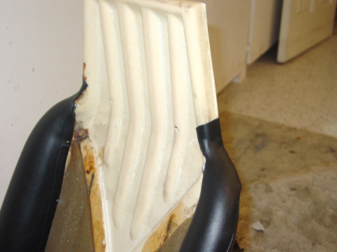

Glue the "shoulders", stretching them as high as possible.

nick mironov Backpad re-upholstering:
First remove the seats.
... May 14 2007, 10:16 PM
