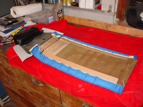

Back to the backpad.

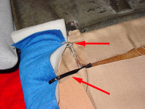

Install the new cover over the backpad foam padding. You will lots of spray-on glue here, and you may need to get some weight on it overnight while it cures.
Install the metal hooks at the top of the fabric. I ended up adding some zip-ties to help shape the top better.
Install the metal wire bead in the bottom pocket.
