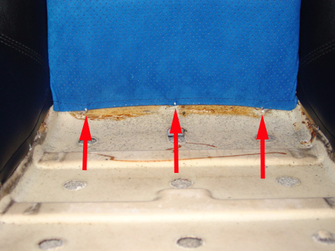

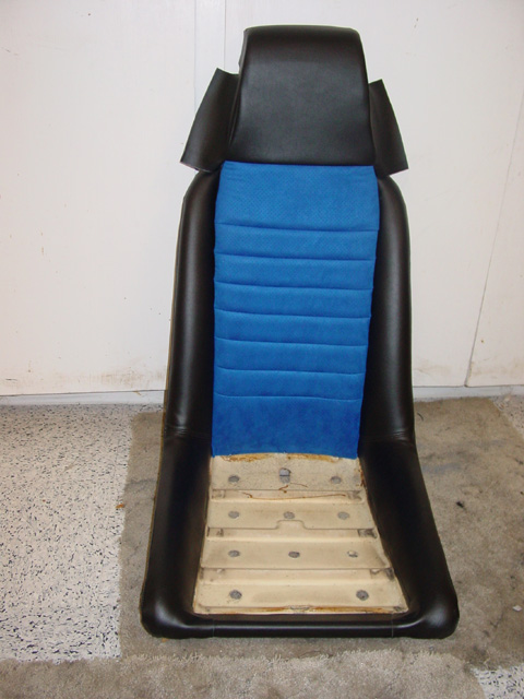

Install the backpad over the seat.
Hook the headrest on over the lip on the top of the seat and then swing the bottom down. It should go on easy - no need to force it.
Stretch the backpad down and pierce the fabric over the bottm bead with the three pointy hooks, and then bend the hooks down to secure it.
