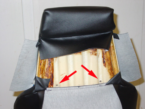

Re-attach the interior screws to hold the headrest in place against the seat.

nick mironov   Remove two screws on the back of the headrest that...   May 14 2007, 11:04 PM

nick mironov   Re-attach the interior screws to hold the headrest...   May 14 2007, 11:43 PM
