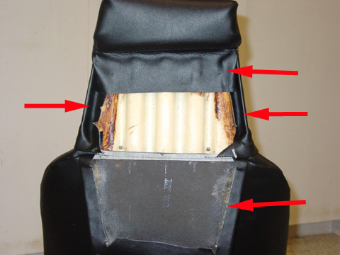

This shows how to re-upholster late model backpad and seats using pre-made kits.
This thread should nicely complement the excellent How to Restore Headrest, Tutorial with Pictures thread in the classics forum.
My kits came from Autos International - ask for Auggie. Nice guy, very helpful, did extra research for me, sent samples, and used custom fabric and perforation.
I also found kits at World Upholstry, but they did not want to deal with other than vinyl or leather fabric, and I wanterd the perforated suede. I think that there are other upholstery kits available as well.
Basic costs are about $200 a seat and $200 for the backpad. Mine were a little more because of the perforated "suede" material from Miami Corp that I elected to use.
At first I thought that I would try to sew the upholstery myself, using the existing pieces as templates. I finally decided against it and I am very glad that I did not attempt to sew.
The only problem that I had was that the seat headrest fabric fit too loosely. Autos International would have fixed it, but I took care of it myself by re-stitching some of the seams. I am sure that they would have done it better than I did, but I did not want to send them the headrests and wait to get them back. If you choose Autos International, I recommend that you send them your headrests for proper fitting.
After shooting a number of pictures, I found that my camera was starting to act up and finally failed. Many of the pictures were unfortunately not salvageable, so I only chose the best ones, and the presentation is not as detailed as I had hoped it would be.
Mt 914 is a V8 conversion with 16" 4-lug Superlight wheels.
Carpet kits are by Morph.
Make sure that you have a good staple gun and get 2 large cans of spray-on adhesive (I used 3M Super 77) and two tubes of rubber cement (I used Barge Cement)
Very important: Remove the fabric from only one piece or seat at a time, leaving the other intact for you to reference the details during the re-assembly process.

Spray adhesive and glue in the backing into the cover flap.
Spray adhesive and glue in the loose pieces/flaps.
Punch holes for the cover flap screws.
Close the flap and install the screws that hold the flap in place.

nick mironov   The seats are next. Disassemble only one at a tim...   May 14 2007, 11:01 PM
nick mironov   Remove two screws on the back of the headrest that...   May 14 2007, 11:04 PM
nick mironov   Remove the backpad. Note the three hooks at the ba...   May 14 2007, 11:09 PM
nick mironov   This picture shows the backside of the backpad. No...   May 14 2007, 11:09 PM
nick mironov   Now remove the seat rails using a hex key on the a...   May 14 2007, 11:13 PM
nick mironov   Remove the seat cover fabric. Note that it is held...   May 14 2007, 11:16 PM
nick mironov   Pull the wire beads out from the side pockets. I p...   May 14 2007, 11:18 PM
nick mironov   Disassemble the backpad. Very carefully, using you...   May 14 2007, 11:22 PM
nick mironov   You are now ready to start re-upholstering the sea...   May 14 2007, 11:29 PM
nick mironov   Work the fabric by stretching the wrinkles out.   May 14 2007, 11:30 PM
nick mironov   Spray glue on the botton of the seat and on the fa...   May 14 2007, 11:31 PM
nick mironov   Glue the "shoulders", stretching them as...   May 14 2007, 11:35 PM
nick mironov   Back to the backpad. Install the new cover over t...   May 14 2007, 11:38 PM
nick mironov   Install the backpad over the seat. Hook the headr...   May 14 2007, 11:41 PM
nick mironov   Re-attach the interior screws to hold the headrest...   May 14 2007, 11:43 PM
nick mironov   Spray adhesive and glue in the backing into the co...   May 14 2007, 11:46 PM
nick mironov   Finally the seat cushions... These are the easies...   May 14 2007, 11:52 PM
nick mironov   And the finished product again...   May 14 2007, 11:53 PM
