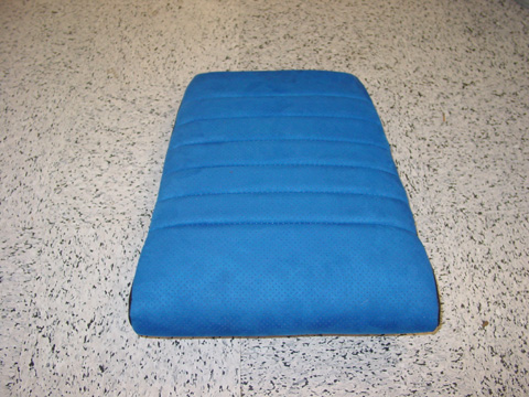

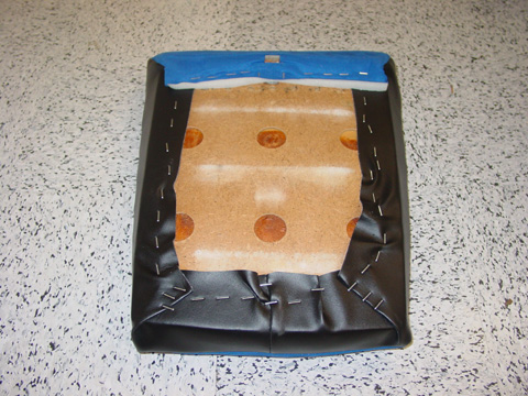

Finally the seat cushions...
These are the easiest of all.
Simply remove the staples the bottom, peel off the old fabric, stretch the new fabric over the foam padding, and re-staple everything.
Install the cushion in the seat, and you are done with the re-upholstery!
Note there there was a complicated string/bead tie-down system in the cushions that I decided not to re-install. There were originally meant to hold the top of the seat cushion down to keep it from bulging/doming in the center. There is no noticable difference without them.
