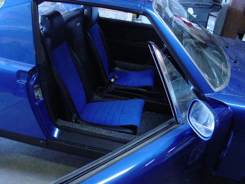

This shows how to re-upholster late model backpad and seats using pre-made kits.
This thread should nicely complement the excellent How to Restore Headrest, Tutorial with Pictures thread in the classics forum.
My kits came from Autos International - ask for Auggie. Nice guy, very helpful, did extra research for me, sent samples, and used custom fabric and perforation.
I also found kits at World Upholstry, but they did not want to deal with other than vinyl or leather fabric, and I wanterd the perforated suede. I think that there are other upholstery kits available as well.
Basic costs are about $200 a seat and $200 for the backpad. Mine were a little more because of the perforated "suede" material from Miami Corp that I elected to use.
At first I thought that I would try to sew the upholstery myself, using the existing pieces as templates. I finally decided against it and I am very glad that I did not attempt to sew.
The only problem that I had was that the seat headrest fabric fit too loosely. Autos International would have fixed it, but I took care of it myself by re-stitching some of the seams. I am sure that they would have done it better than I did, but I did not want to send them the headrests and wait to get them back. If you choose Autos International, I recommend that you send them your headrests for proper fitting.
After shooting a number of pictures, I found that my camera was starting to act up and finally failed. Many of the pictures were unfortunately not salvageable, so I only chose the best ones, and the presentation is not as detailed as I had hoped it would be.
Mt 914 is a V8 conversion with 16" 4-lug Superlight wheels.
Carpet kits are by Morph.
Make sure that you have a good staple gun and get 2 large cans of spray-on adhesive (I used 3M Super 77) and two tubes of rubber cement (I used Barge Cement)
Very important: Remove the fabric from only one piece or seat at a time, leaving the other intact for you to reference the details during the re-assembly process.
Finished Interior:

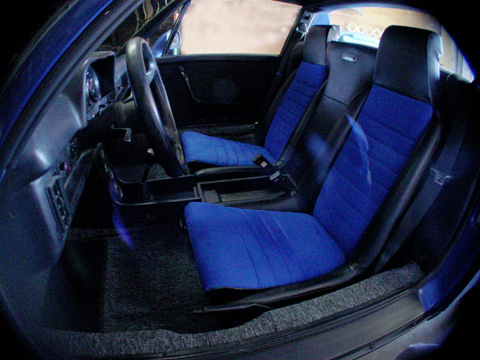

And the finished product again...
