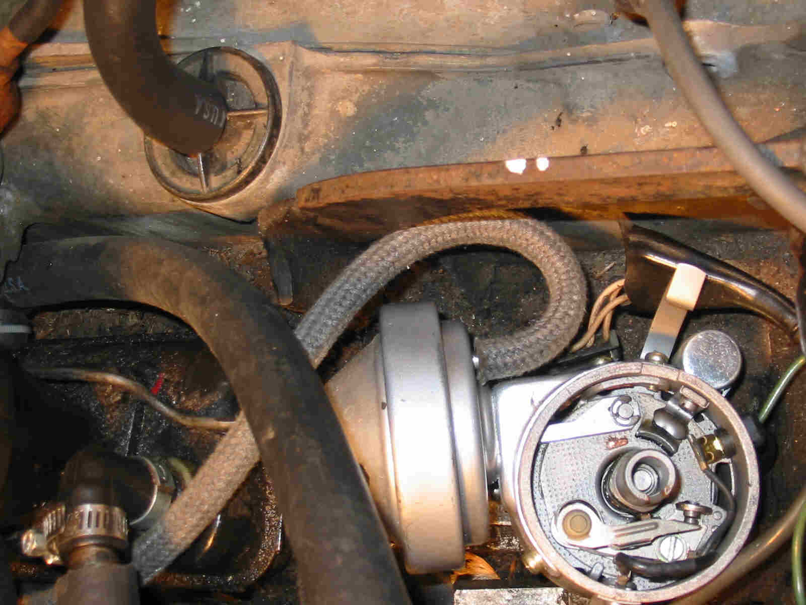

Rich- Thats good info. I set the dwell to 48 deg. now, starts quicker, still acts the same but does run a little longer
I am attaching a picture of my distributor position.

John   I see two things that confuse me with your picture...   May 21 2007, 10:05 PM
rettigdw914   The hose to the fan shroud goes back to the charco...   May 22 2007, 01:27 PM
