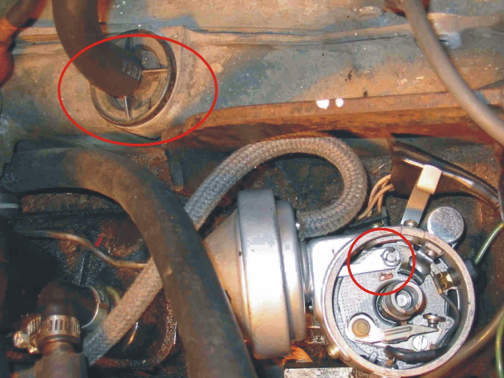

I see two things that confuse me with your picture.
I circled them in red.
1. What is the tube going to the timing access hole plug?
2. Is the tiny bit of copper braid on the points plate supposed to be the ground connection? If so, it is broken and may not be providing the ground that your points need to function correctly.
