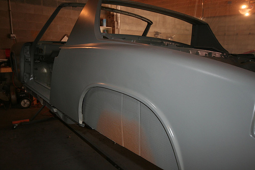

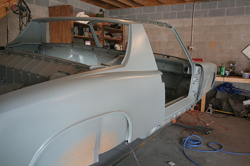

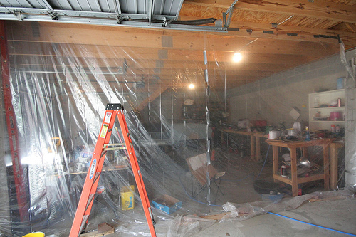

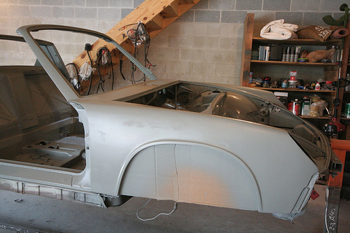

So, painting.... Its fun, but it looks that I am going to be as slow a painter as I was a welder and a body man.
Pics:
First, the paint booth, to make sure that I don't paint my wife's car. Its not perfect, but it works well enough. You can see the 914 behind the plastic.
(IMG:http://www.914world.com/bbs2/uploads_offsite/farm1.static.flickr.com-179-1274377277.1.jpg)
2 coats of epoxy sealer/primer yeilded this:
(IMG:http://www.914world.com/bbs2/uploads_offsite/farm1.static.flickr.com-179-1274377278.2.jpg)
(IMG:http://www.914world.com/bbs2/uploads_offsite/farm1.static.flickr.com-179-1274377279.3.jpg)
(IMG:http://www.914world.com/bbs2/uploads_offsite/farm1.static.flickr.com-179-1274377279.4.jpg)
I'll be the first to admit it is not perfect. This morning I went out to look at last night first coat, and found all sorts of body irregularities that I could not see when it was steel and body putty. So, I mixed up more filler, and went to work leveling things out. I also found a few pinholes in the filler that I am going to need to close. I had not seen them before, and was hoping not to need a glaze. After sanding the filler down, I put on another thin coat on one or two spots that warrented it, and sanded it again.
I wiped the car down again with wax and grease remover, and then dusted with a tack cloth.
Last night, I had the pressure set at 30 PSI at the hose, and that was too high, got runs too fast. So I set it this time for 20 PSI. My test spray looked okay, but as soon as I put it on the car I saw it was crap. Not enough pressure to atomize the spray, so I am going to need to sand that out. I raised it to 25 PSI and that seemed to work well. Nice spray, but not laying so fat that it runs.
Somehow, I found dust, again, on the same quarter panel fender that I needed to sand any how. So, that will have to be sanded out too.
The rest of the car went well, except for a run at the rear where I was not paying attention. *sigh*
There are areas where the paint lays differently over the body filler then the metal. I hope that is just how sealer works, and when I spray the sandable primer that will just cover over.
So, its not perfect, and I still have a long way to go, but MAN do I feel happy to see the car one color!
