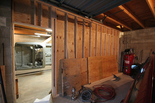

As of Friday night, this is how I had my "shop" part of the garage separated from the rest of the garage:
(IMG:http://www.914world.com/bbs2/uploads_offsite/farm1.static.flickr.com-179-1274377413.1.jpg)
As of Saturday night, it looked like this:
(IMG:http://www.914world.com/bbs2/uploads_offsite/farm1.static.flickr.com-179-1274377413.2.jpg)
I love it when I get to build things. This has freed up _SO_ much room in my shop - which I can now consider a shop as it is a separate room from the garage.

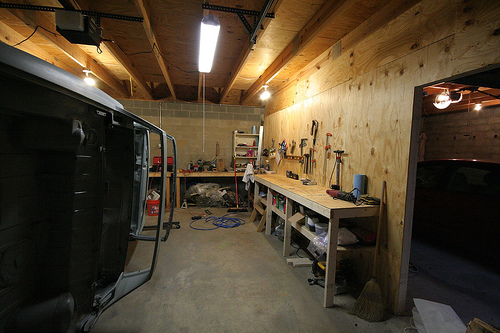

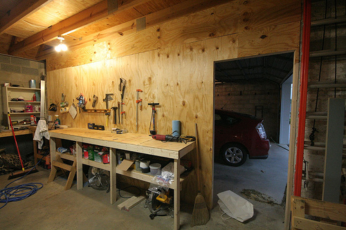

The inside now looks as such:
(IMG:http://www.914world.com/bbs2/uploads_offsite/farm2.static.flickr.com-179-1274377414.3.jpg)
(IMG:http://www.914world.com/bbs2/uploads_offsite/farm2.static.flickr.com-179-1274377414.4.jpg)
Aside from the obvious wall and workbench, I added doublers to the existing light fixtures (as well as putting in CFLs instead of incandescents) and 2 hanging shop fluorescent light banks as well. I can actually see what is going on in there.
