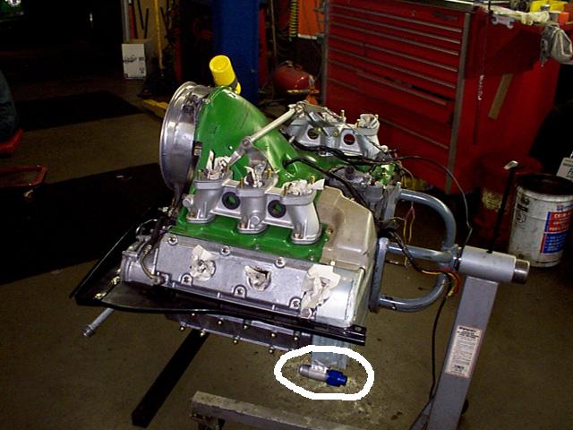

I have 911 and 914 6 oil coolers. I'm curious what the conversion guys do to make the 911 cooler work? Different oil lines? Modify the cooler?

That looks interesting...
...I just cut and put in a 90 degreee bend in mine (pointing the other way, if the oil line connects to the blue fitting there) Nice engine! Attached image(s)

seanery Richard Clewett did mine: 2.7 pics

campbellcj I had Ottos convert a 911 cooler, which is the way... Nov 28 2003, 04:53 PM
seanery blue fitting is for changing the oil. Oil line con... Nov 28 2003, 05:54 PM
meursault I do kinda like the "t" fitting idea. I tried to g... Nov 29 2003, 12:17 AM
Mike D. I like the T idea. Mine just has a 90 degree fitti... Nov 29 2003, 12:46 AM
! On my 3.0 conversion, I cut an elbow from a prefor... Nov 29 2003, 10:06 AM
Eric_Shea Curious...
When doing a 6 with a GT front cooler ... Nov 29 2003, 11:02 AM
! The mod is needed because the line coming off the ... Nov 29 2003, 11:04 AM
Brad Roberts Yep. The Clewitt setup is the way to go if you don... Nov 29 2003, 11:23 AM
