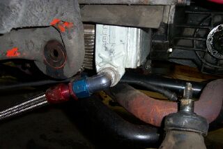

I have 911 and 914 6 oil coolers. I'm curious what the conversion guys do to make the 911 cooler work? Different oil lines? Modify the cooler?

I like the T idea. Mine just has a 90 degree fitting welded to it. I didn't do it, don't know who did, Brad mayby, it just came this way.
-Mike D. Attached image(s)

campbellcj I had Ottos convert a 911 cooler, which is the way... Nov 28 2003, 04:53 PM
seanery blue fitting is for changing the oil. Oil line con... Nov 28 2003, 05:54 PM
meursault I do kinda like the "t" fitting idea. I tried to g... Nov 29 2003, 12:17 AM
! On my 3.0 conversion, I cut an elbow from a prefor... Nov 29 2003, 10:06 AM
Eric_Shea Curious...
When doing a 6 with a GT front cooler ... Nov 29 2003, 11:02 AM
! The mod is needed because the line coming off the ... Nov 29 2003, 11:04 AM
Brad Roberts Yep. The Clewitt setup is the way to go if you don... Nov 29 2003, 11:23 AM
