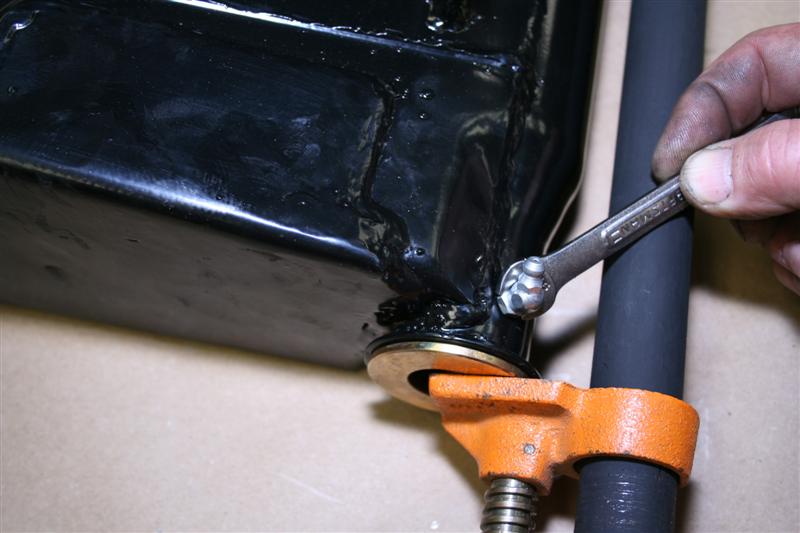

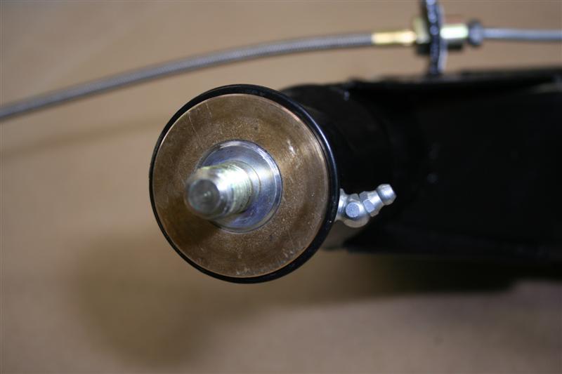

The Poly-Bronze are great. No problems with the grease fitting unless you install them the way the instructions show. I let Chuck know that they need to revise the instructions but I don't know if that has been done. Here is the correct location.
