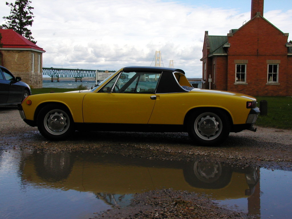

I can carry (4) bottles of "Two Buck Charlie Wine"
You can't get Two-Buck Chuck in Michigan... silly boy.
Gary has a 914-6? (IMG:style_emoticons/default/confused24.gif)

QUOTE(Eric_Shea @ Jul 3 2007, 02:53 PM) *
Why would you think I don't have a Six????? Must be old age.
