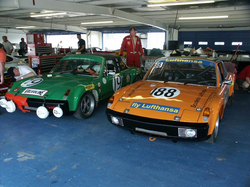

iamchappy   Zach I too have been under the gun to get my car p...   Jul 3 2007, 08:59 PM
Vacca Rabite   ^^^ That Aircooled Racing car was the one that sol...   Jul 4 2007, 11:55 AM
