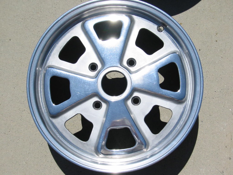

ok, set aside some time tomorrow to polish my 2.0 fuchs, which many people have told me need it (IMG:style_emoticons/default/biggrin.gif) (thanks all)
I used the search function, and couldnt find too much...so, what is the best way??? I dont want to remove the anodizing, so should I go with the "mothers" power ball, and metal polish, or the actual mothers wheel polish??? I want the non-anodized parts to be nice and chrome(y) (IMG:style_emoticons/default/biggrin.gif)
thanks all in advance.... -JON

Dan (Almaden Valley)   can't polish the wheels without removing the a...   Jul 4 2007, 07:33 PM
orthobiz   can't polish the wheels without removing the ...   Jul 5 2007, 07:37 PM
Dan (Almaden Valley)   can't polish the wheels without removing the...   Jul 5 2007, 07:57 PM
sendjonathanmail   i currently have this stuff on my shelf... coul...   Jul 4 2007, 07:39 PM
Dan (Almaden Valley)   i currently have this stuff on my shelf... cou...   Jul 4 2007, 08:42 PM
Gint   I used the search function, and couldnt find too m...   Jul 4 2007, 08:23 PM
914rrr   Any tips on removing paint from the recessed areas...   Jul 4 2007, 09:29 PM
orthobiz   Any tips on removing paint from the recessed area...   Jul 4 2007, 10:43 PM
ConeDodger   I guess my question would be how to remove the ano...   Jul 4 2007, 09:55 PM
George H.   paul i believe he's talking about wheels that ...   Jul 5 2007, 01:40 AM
orthobiz   paul i believe he's talking about wheels that...   Jul 5 2007, 05:48 AM
914rrr   paul i believe he's talking about wheels that...   Jul 5 2007, 08:45 AM
914rrr   I found a link that tells DIY'ers how to remov...   Jul 5 2007, 08:56 AM
jasons   Looks like lye will remove it. Another site said...   Jul 5 2007, 09:07 AM
orthobiz   Or oven cleaner, which I think is basically lye....   Jul 5 2007, 10:25 AM
Gint   So does... +polish* +fuch* ...and if you search ...   Jul 5 2007, 02:02 PM
Joe Ricard   When I did a set I just sanded through the anodize...   Jul 5 2007, 02:43 PM
orthobiz   Just in case you were to pay someone to do them, I...   Jul 5 2007, 07:34 PM
Dan (Almaden Valley)   and   Jul 5 2007, 07:57 PM
Dan (Almaden Valley)   not as nice as the professionals job, but for the ...   Jul 5 2007, 08:02 PM
