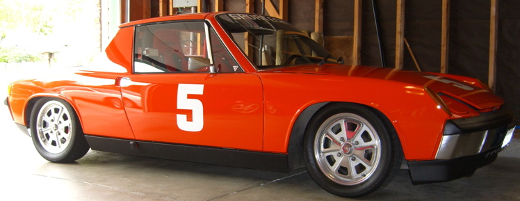

not as nice as the professionals job, but for the time and money I spent to do them for a track car, they are just fine.
If I were to do them again, which I probably will do in the winter, I will spend more time on each wheel and use some heavier compound on the wheels after the sanding before I go to the metal cream (polish)
here they are on the car.
