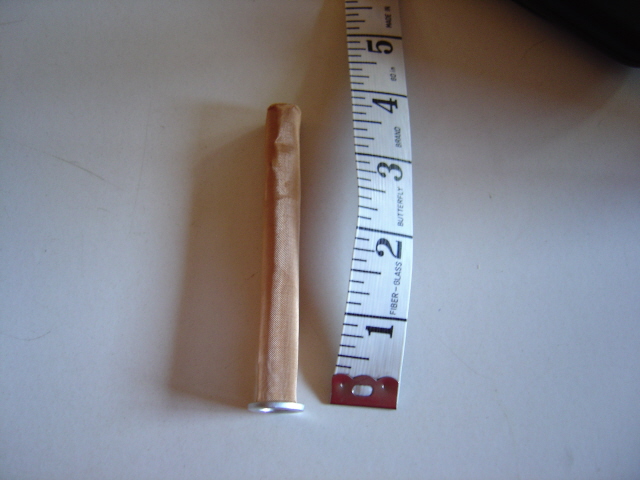

I went and got a new strainer sock for the tank...

McMark   I've bought the sock at a bug shop before. Bu...   Jul 3 2007, 08:19 PM

McMark   Watch out for reusing the sock. The flash aluminu...   Jul 4 2007, 01:27 PM
Danny_Ocean   Watch out for reusing the sock. The flash alumin...   Jul 4 2007, 04:02 PM
McMark   Watch out for reusing the sock. The flash alumi...   Jul 5 2007, 02:01 AM

Phoenix914   Those strainer socks are readily available from th...   Jul 5 2007, 07:46 AM
Bogaat   Those strainer socks are readily available from t...   Jul 5 2007, 10:58 AM
McMark   It is installed from the outside. :confused:   Jul 5 2007, 11:01 AM
Bogaat   It is installed from the outside. :confused: H...   Jul 5 2007, 11:05 AM
rhodyguy   take off the capturing nut on the supply tube and ...   Jul 5 2007, 11:06 AM
