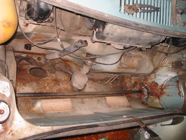

Took out the gas tank and it indeed is full of stromberg.gif . I'll let the pics tell the rest:
BahnBrenner914
The tank:
BahnBrenner914
The gas from the bottom of the tank that didnt syphon out: barf.gif
BahnBrenner914
and inside the tank (if you have small children in the room, you'll want them to leave): barf.gif icon8.gif stromberg.gif
McMark
Yup, not surprised given the issues you've been having. And you've even got HOLES!
Time to go tank hunting.

By the way, I just wanted to note that your fuel tank compartment looks pretty darn clean. Mine did not look that good...
