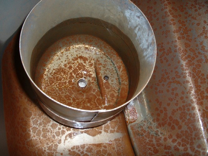

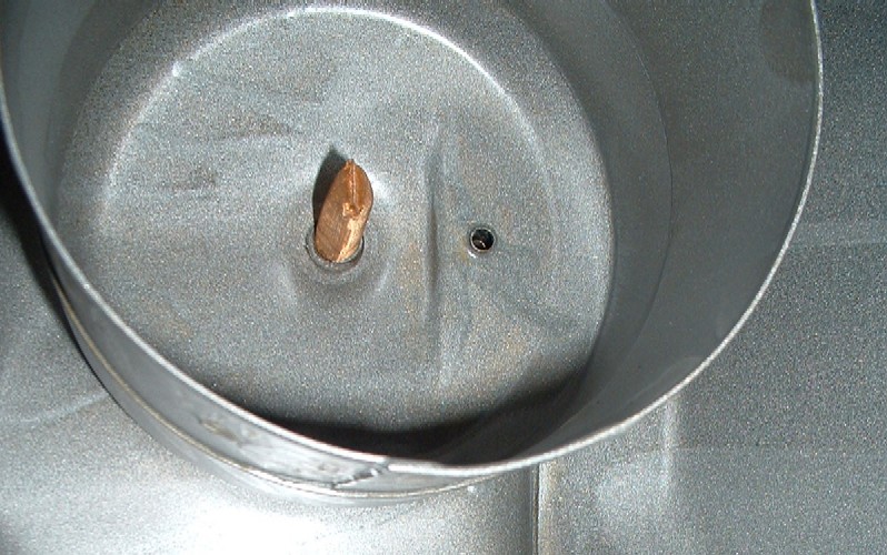

I did the POR-15 route. Here's the before and after- (I've posted this before) I wasn't dealing with as much as you are. The POR treatment took care of the surface rust before the final sealing.

jk76.914
QUOTE(jk76.914 @ Jul 4 2007, 05:26 PM) *
Those are my pics. You're all welcome to them.
A couple of lessons learned by me-
regarding the flash rust (great term)- When I completed step 2, I rinsed it by putting a hose in one of the big holes on top. I let it spray with both tubes off at the bottom. The combination of running water and air flashed stripes of rust going down the inside of the tank, and I had to do step 2 all over again. The next time, I kept the bottom holes plugged, and rinsed by filling the tank full, then draining it quickly. I did it 3 times to flush it, and no rust. I'm guessing the lack of air slowed down the rust action.
after step 2, I put the vacuum hose from my shop vac into the filler hole on top, and put the end down to the deepest section of the tank. While it was sucking, I blew into the fuel level sender hole with my heat gun on medium. It worked great. I could feel the bottom of the tank heat up, and I could see the wetness disappearing when I peeked in around the heat gun with a flash light.
When I removed the tubes on the bottom and the sock, I munged up the thread on one of the nipples. It was a pain with magnifying glasses and jewelers files to clean it up, so be careful. Also, I learned that the nut is aluminum- very soft and easily damaged. I got new ones from Stoddard- they had to backorder from Germany but they came in about a week for only maybe $3 or so each.
This one will be controversial- To seal the tubes and the sock, I installed them while the POR-15 sealant was still wet. It's now TOTALLY permanent, but I didn't want to fool around with leaks, and, after 98000 miles and 30 years, my sock was still OK (replaced it anyway), so what the heck.

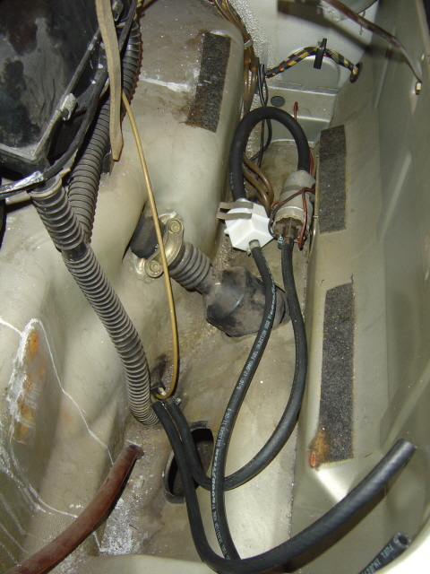

So the tank is all cleaned out stirthepot.gif and I installed new hose under the tank:
BahnBrenner914
Then installed tank, fuel gauge, expansion chamber...

boxstr
I would hold off on filling the tank to the top. Fill part way then start the car and drive for a short distance then, If everything is tight and no leaks, fill the tank.
One thing I like to do when the tank is out, is move the pump and fuel filter to the side of the front trunk area, on th eearly 914s even on a 75-76 914. That way if you have to change the filter. You do not have to jack the car up. Trust that the jack stands will hold and slide under the car, loosen the hose clamps, gas dripping down, remove the old filter and gas dripping down, install the new filter and tighten the clamps.

So is the best place to mount the pump/filter under the tank in the cavity? Mine is currently underneath the car behind the "skid" plate rather than in the confines of the gas tank body cavity. It had previously been relocated. It seems it would be easier to get to from underneath when replacing?
boxstr
The early 914s 70-74 had the pump and filter mounted at the midsection passenger side, near the heater tubes. Good place to casue vapor lock and heated fule problems.
The 75-76 pumps and filter were mounted as you see in teh previous pics, under the tank and the pump secured to a small access cover that you pull out, through, and into the front trunk area.
This is the better of the factory locations, IMHO.
But, if you have the tank completely out, I prefer to move the pump and filter into the side wall area in the front trunk.
I will try and post a pic.
