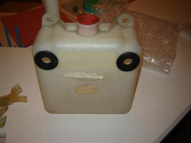

It took me forever to find a original. Mittelmotor in Germany has new ones. Part number is 901 107 083 00.
Here is mine:
And where it's been hiding!

kckoch   It took me forever to find a original. Mittelmoto...   Jul 13 2007, 10:04 PM
Eric_Shea   Interesting that it has an oil system part number ...   Jul 13 2007, 10:21 PM
kckoch   I'll add this one for fun! Note: Comple...   Jul 13 2007, 10:24 PM
Eric_Shea   (*&%*%^@$)(*&$&%*&% ...   Jul 13 2007, 11:00 PM
davep   The GT parts manual lists part # 901 628 720 22, a...   Jul 14 2007, 08:20 AM
kckoch   Your number may be correct, and the application th...   Jul 14 2007, 09:23 AM
Eric_Shea   No doubt they're different tanks. Kevins is n...   Jul 14 2007, 11:30 AM
davep   The application seems to be a 1967, 1968 911/912 w...   Jul 14 2007, 11:48 AM
kckoch   I would agree dave. I think it was an after thoug...   Jul 14 2007, 06:54 PM
