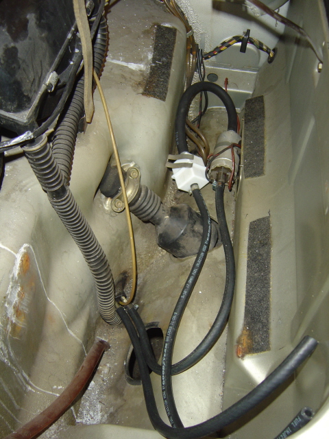

So the tank is all cleaned out (IMG:style_emoticons/default/stirthepot.gif) and I installed new hose under the tank:

BahnBrenner914 I went and got a new strainer sock for the tank... Jul 10 2007, 08:17 PM
BahnBrenner914 Then installed tank, fuel gauge, expansion chamber... Jul 15 2007, 11:28 PM
McMark You may have the hoses get kinked after the first ... Jul 15 2007, 11:53 PM
