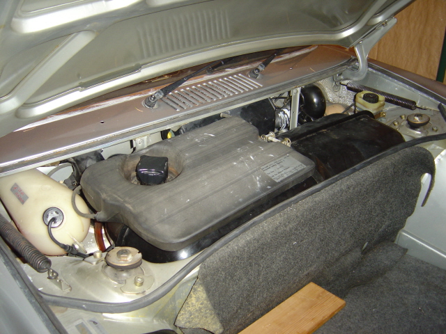

Then installed tank, fuel gauge, expansion chamber...

BahnBrenner914   So the tank is all cleaned out :stir: and I inst...   Jul 15 2007, 11:26 PM
BahnBrenner914   Then installed tank, fuel gauge, expansion chamber...   Jul 15 2007, 11:28 PM
McMark   You may have the hoses get kinked after the first ...   Jul 15 2007, 11:53 PM
BahnBrenner914   You may have the hoses get kinked after the first...   Jul 16 2007, 02:00 AM
boxstr   I would hold off on filling the tank to the top. F...   Jul 16 2007, 09:59 AM
Bogaat   I would hold off on filling the tank to the top. ...   Jul 16 2007, 10:25 AM
BahnBrenner914   I would hold off on filling the tank to the top. ...   Jul 16 2007, 01:25 PM
boxstr   The early 914s 70-74 had the pump and filter mount...   Jul 16 2007, 10:56 AM
