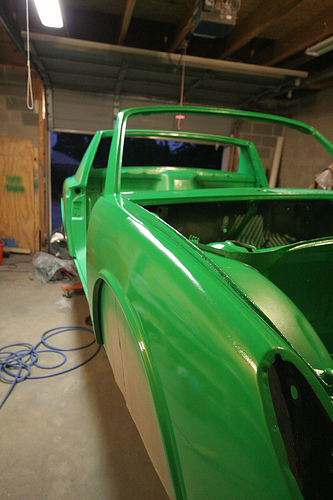

Today after work I put more paint on the car, and also painted the top and both trunks. I still need to do the doors.
I took 3 pics, but only one fo them got anywhere near the actual color of the paint.
So, here it is.
(IMG:http://www.914world.com/bbs2/uploads_offsite/farm2.static.flickr.com-179-1274378063.1.jpg)
I still need to do a lot of wet sanding. Likely, that will start when I get back from Cancun, as I doubt I'll have time to do much of it until then.
I have gotten MUCH better at painting. No runs or sags. Not much orange peel (but there is a little). I can see more places that should be filled and leveled, and I may or may not go back and do it. I should, I have PLENTY of paint. but I want to get the painting done and start getting it back together. *impatient*
its really nice to see the car as one color again. *REALLY NICE*.
There are some parts that I have not even begun to prep yet (the fiber glass rockers, the headlamp covers, and the little parts that go in front of the eyebrow.) I'll got to them eventually.
Zach
