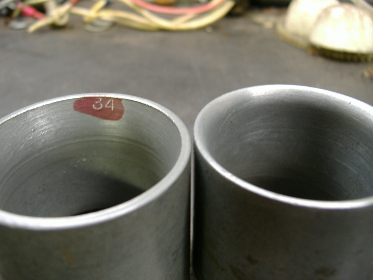

Attached ImageHere's a pic of the venturi out of the carb....the one on the left shows the number (with a bit of highlight...they can be a booger to see) and is "right side up", or the way it would be installed in the carb. The right one is upside down and you can see the fairly pronounced radius on the bottom end. This would be nearest the throttle plates when installed.
Of course it's always possible someone removed the numbers.....there's a fun thought.

BxtrBill   Here's a pic of the venturi out of the carb......   Jul 17 2007, 10:04 PM
terrymason   So, there's a blunt end, and a tapered end? T...   Jul 17 2007, 11:29 PM
Twystd1   I just went through this with some other 914 breth...   Jul 18 2007, 03:06 AM
Joe Ricard   That' odd having the blunt end of the Venturi ...   Jul 18 2007, 06:00 AM
type11969   I'm pretty sure that is reversed, I'm almo...   Jul 18 2007, 07:03 AM
BxtrBill   I'm pretty sure that is reversed, I'm alm...   Jul 18 2007, 11:14 PM
