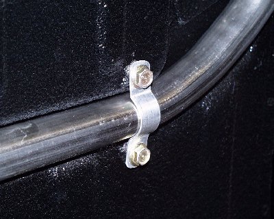

My clamps are made from 1/8" aluminum. Nuts are welded to the flor pan.

QUOTE(Phoenix-MN @ Jul 20 2007, 11:34 AM) *
Paul,
if you want to coat those clamps with rubber (tighter fit, no chance of vibration) look up Loctite USA, under product search "Color Guard". It's a brushable/dipable rubber coating. It's main use is coating tool handles so they are nonslip.
