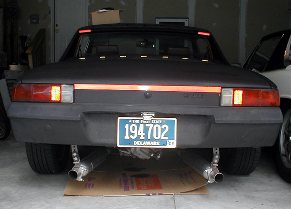

type47   looks like even a V8 marks it's spot. 'cou...   Jul 26 2007, 10:45 PM
jimkelly   i am bringin' it or a van full of 914 parts to...   Jul 27 2007, 06:19 AM
