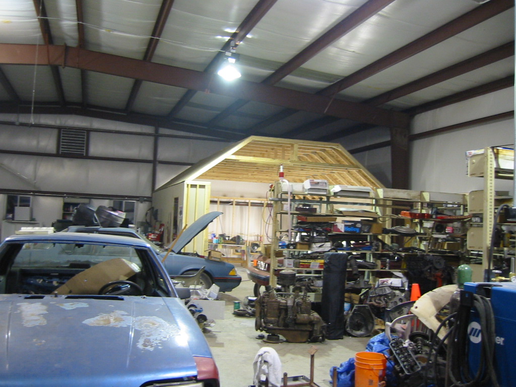

finally, the rest of the shop we share...thats a pait booth being constructed in the corner...the place is kinda junky right now, but we are still getting setup...
Thanks for all your help guys, I hope its a mild winter, so I can have all the kinks worked out of the car for the race season next year...
