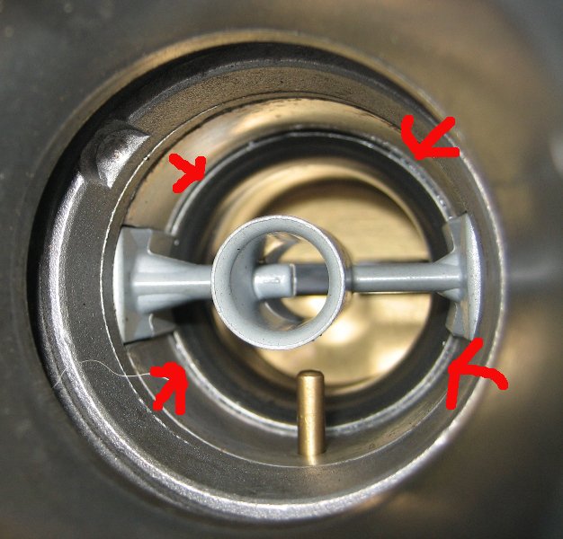

I'm working in Seattle all this week, so won't get to make any changes to the car, but I did snap off a few photos before I left.
Here are my etubes, and a shot down the mouth of one of my carbs. Just so that I'm not loosing it, the main venturi is the large sleeve that the red arrows are pointed at right?

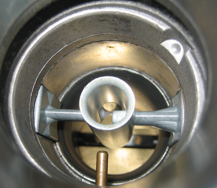

You can actually see the aux venturi below

type11969   Looks like at least that one etube had one of the ...   Jul 17 2007, 07:22 AM
