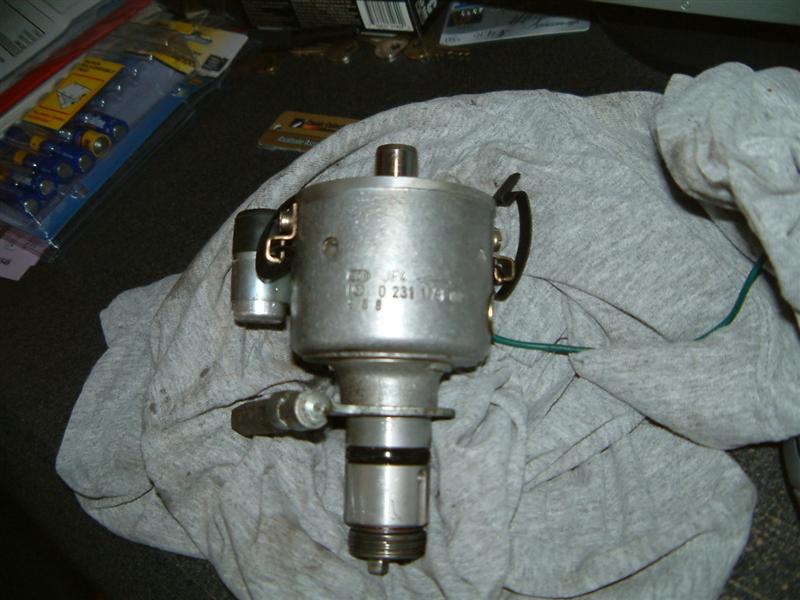

My engine... 1974 1.8 Has dual Weber carbs. Not positive which ones. Distributor appears to be original? I'm assuming that the cam is original, really have no idea. I attached a couple pics that may help identify what I have. Sorry, it's raining outside and the car is covered, can't get better pics at the moment.

I just pulled the dizzy and it looks like it's an 009 like mentioned. (IMG:style_emoticons/default/sad.gif)
Numbers...
908 (with circle around it)
JF4
0 231 178 009
9 6 6
If this dizzy is known to be a bitch, why the heck do people swap out the stock one for it? Would the stock one not be good for carbs? Is this one cheaper than others?
