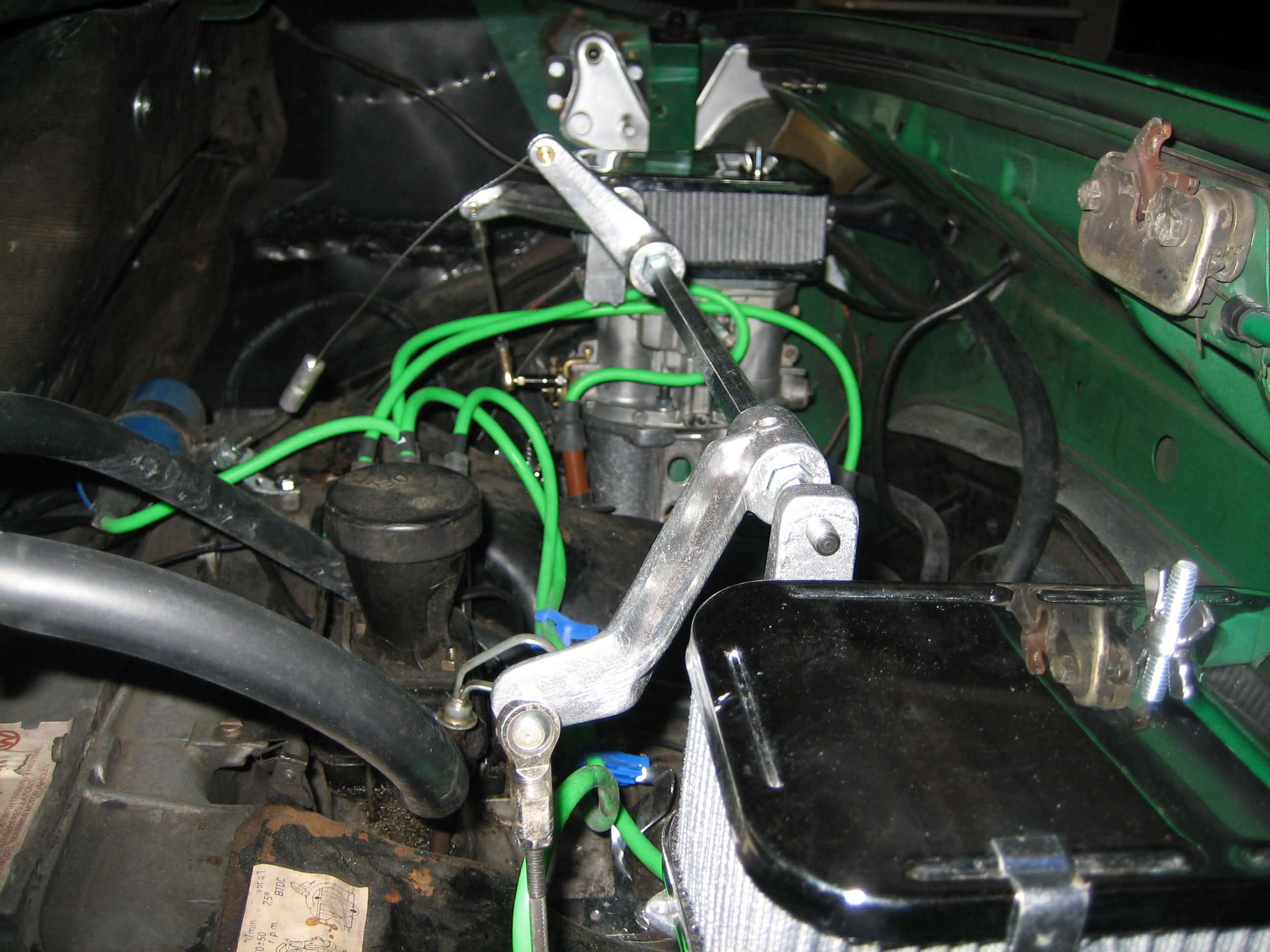

OK,
New fuel filter after the fuel pump (2 now)
I"ve pulled all the old idles and put in new 60s
one pump jet looked clogged, so I pulled it and blew it out.
I"ve also readjusted the linkage, so that they seem to be pretty well in sync.
I'm now getting backfire from the exhaust at low speed, and backfire out the carbs during accelleration.
Does anything look crazy wrong with my linkage to you guys?
If not, then tomorrow I may just pull one carb and begin tearing it apart and cleaning it out.

terrymason   OK, New fuel filter after the fuel pump (2 now) I...   Aug 7 2007, 07:44 PM
terrymason   and another   Aug 7 2007, 07:45 PM
terrymason   another   Aug 7 2007, 07:46 PM
terrymason   and the last one   Aug 7 2007, 07:47 PM
Twystd1   intake leak i sniff. Is that an open vacuum port ...   Aug 8 2007, 03:16 AM
