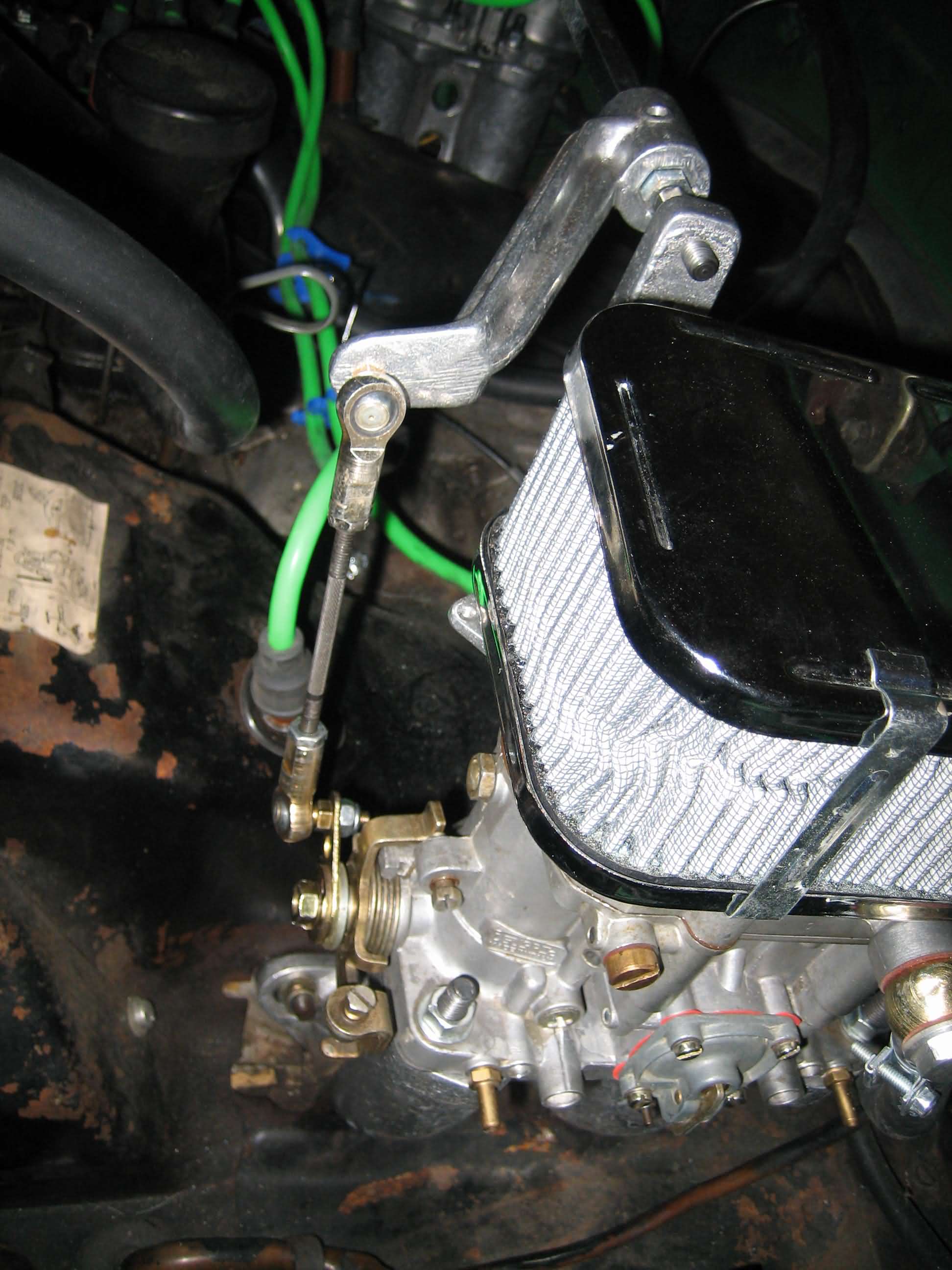

terrymason   OK, New fuel filter after the fuel pump (2 now) I...   Aug 7 2007, 07:44 PM
terrymason   and another   Aug 7 2007, 07:45 PM
terrymason   another   Aug 7 2007, 07:46 PM
terrymason   and the last one   Aug 7 2007, 07:47 PM
Twystd1   intake leak i sniff. Is that an open vacuum port ...   Aug 8 2007, 03:16 AM
type11969   Those should seal when screwed in all the way . . ...   Aug 8 2007, 07:15 AM
terrymason   Success!!! Problem 1 - I think that s...   Aug 9 2007, 03:13 PM
