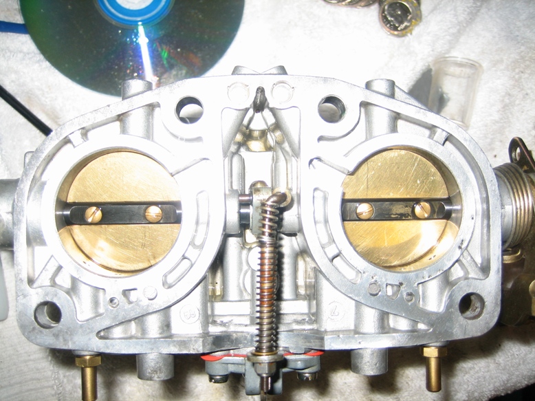

terrymason   You can actually see the aux venturi below   Aug 2 2007, 02:40 PM

terrymason   I'm ready to pull my hair out over this thing....   Aug 7 2007, 09:07 AM
type11969   I'm ready to pull my hair out over this thing...   Aug 7 2007, 11:41 AM

Twystd1   intake leak i sniff. Is that an open vacuum port ...   Aug 8 2007, 03:16 AM
type11969   Those should seal when screwed in all the way . . ...   Aug 8 2007, 07:15 AM
terrymason   Success!!! Problem 1 - I think that s...   Aug 9 2007, 03:13 PM
