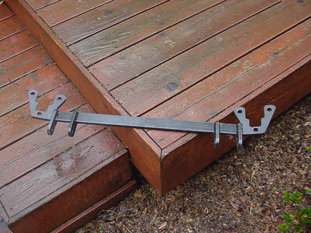

I bought this tow hitch for my 914 and it doesn’t seem to fit flat against body of the car at the top.
Does anyone know if all 914’s are the same where the hitch bolts up? Also does anyone know if this hitch is custom or company made? Yes I did try flipping it. It fits the same way. ![]() ![]() |

is this the dlee tow fixture? i think towing while using the bumper holes has a huge chance of doing body damage and screwing up the way the bumper is going to fit after the fact.

Headrage IMHO, I don't think the hitch is the rub. Fro... Aug 19 2007, 06:55 PM
Aaron Cox :agree:
look into the DLEE towbar method in the r... Aug 19 2007, 07:29 PM
chris914
:agree:
look into the DLEE towbar method in the ... Aug 20 2007, 12:31 AM
davep There were a few changes, but mostly for the 1975 ... Aug 20 2007, 07:05 AM
jd74914 Yep, that looks like the DLee model Kevin. Aug 20 2007, 09:36 AM
