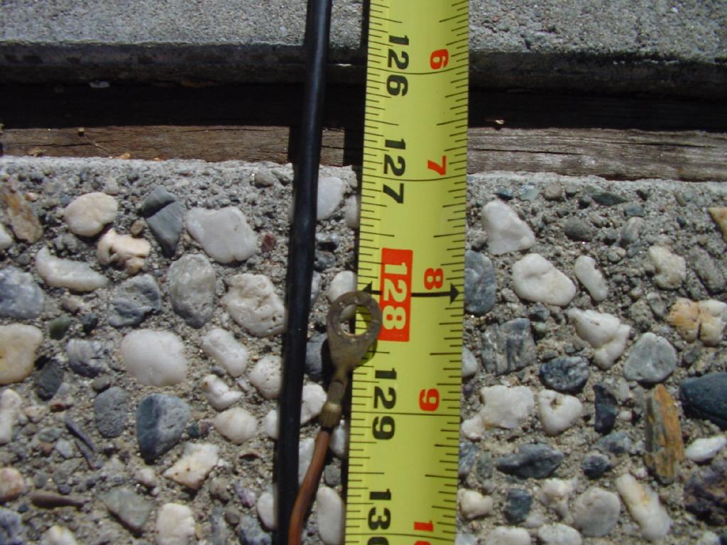

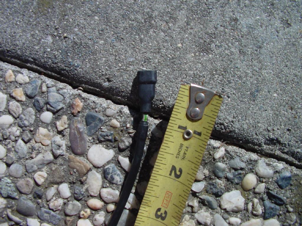

Jeff Bowlsby Below is the photo of the end of the harness to th... Nov 13 2007, 04:36 PM
davep I estimate at least 3" of white wire to go th... Nov 13 2007, 08:37 PM
Eric_Shea
The white/green wire exits the body panel and im... Nov 14 2007, 12:37 AM
