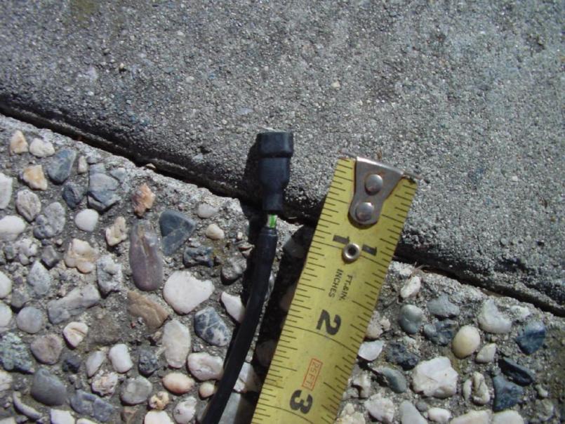

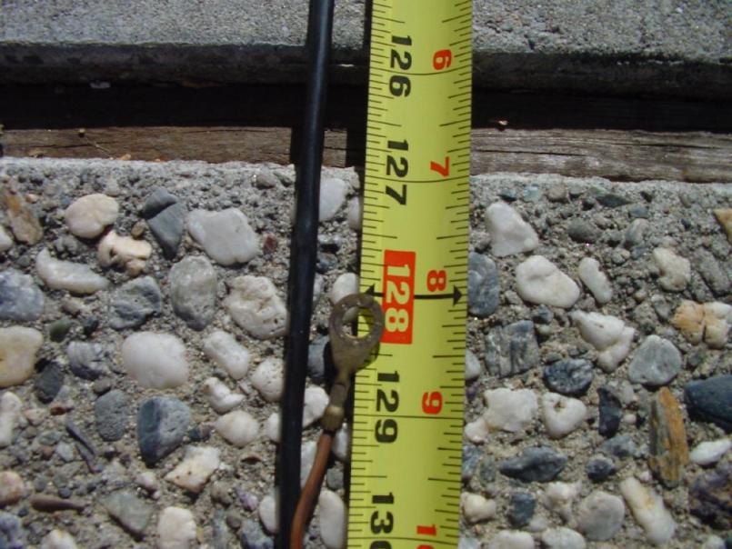

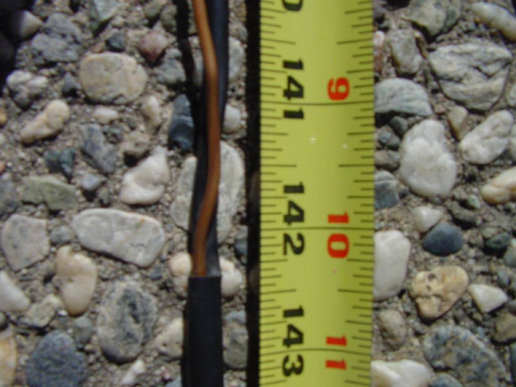

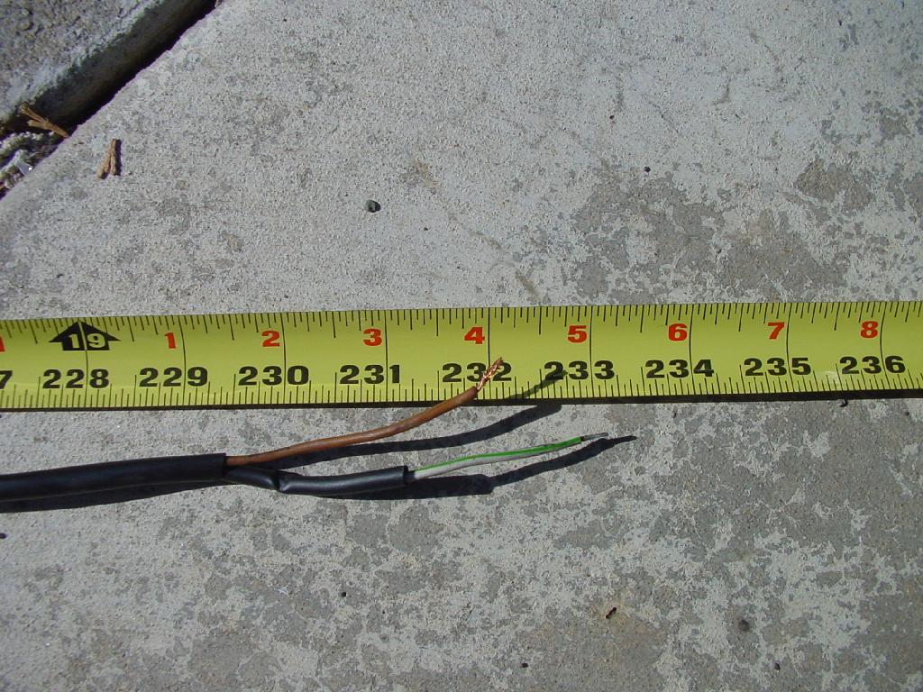

And to remove the rear foglight harness from my '74. (I won't be needing it for the EV conversion, and the rear solenoid I was using it for died a long time ago!)
Any get-togethers coming up? 9:14 Breakfast at IHOP? Anything? (IMG:style_emoticons/default/chowtime.gif) I'd prefer handing this to Jeff in person...
Here's a few pics of it stretched out for those that can't wait:
Oh, and I'm almost positive that the wires were just stripped and tinned at the back end, one still had the solder on it when I "Un-crimped" the connector.

More pics:
