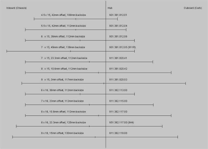

ss6   Mike Z - Awesome diagram! Tells you everyth...   Dec 7 2003, 01:26 PM
