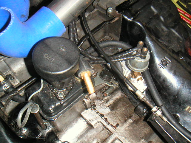

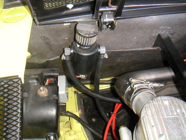

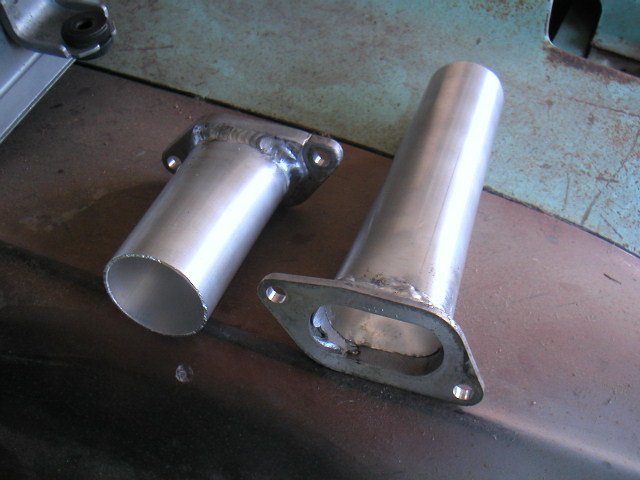

Moving on to other work, I re-plumbed the puke tank to have an individual line from each head into it, with the lines going up from each head, no low spots to have anything condense. I also added an elbow and fitting for the oil return from the scavenge pump. The oil supply was already stubbed in when the oil pressure sender was installed. Next is a pic of the oval to round adaptors to get from the 2" round that the ITB hats need, to the oval of the subi intercooler.
