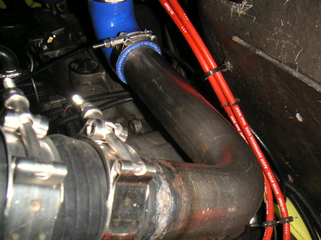

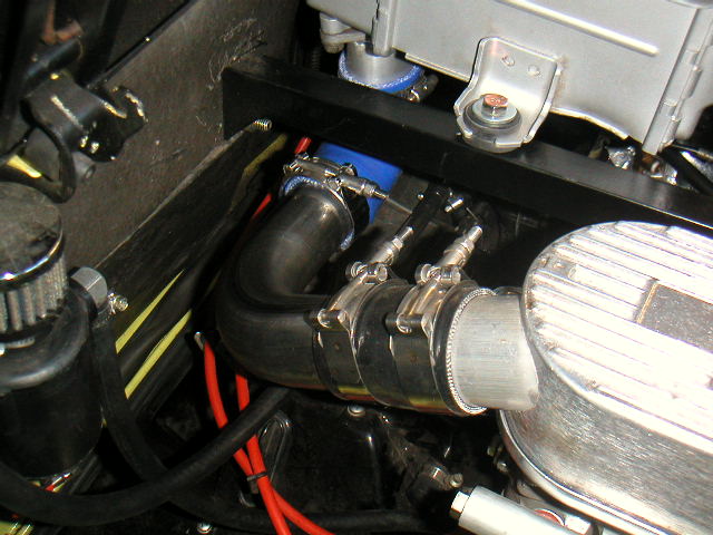

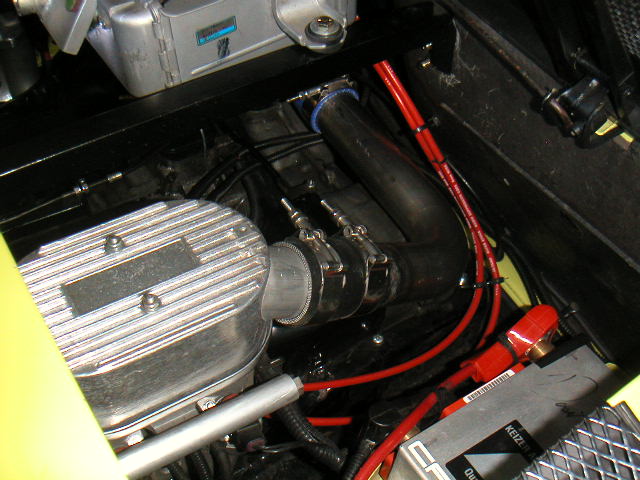

ottox914   Final cuts of tubing, and the masked welder in act...   Sep 13 2007, 10:09 PM
ottox914   Right and left sides completed!   Sep 13 2007, 10:13 PM

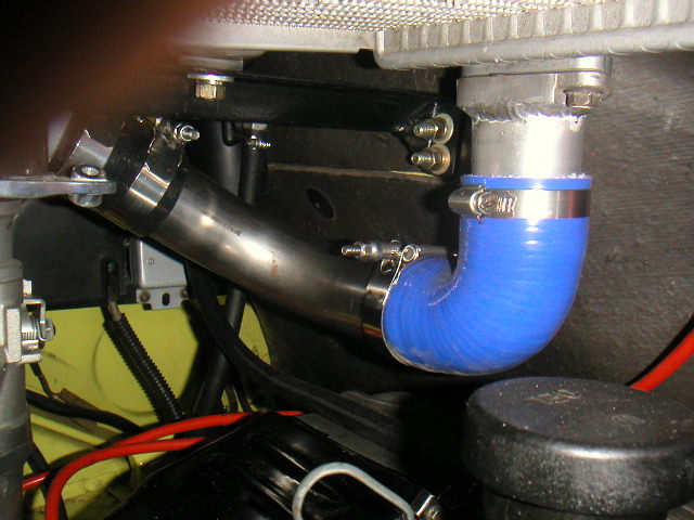

ottox914   Intercooler mounted and connected to the round to ...   Sep 13 2007, 10:23 PM
ottox914   On to the good stuff. Think we'll have to tri...   Sep 13 2007, 10:30 PM
